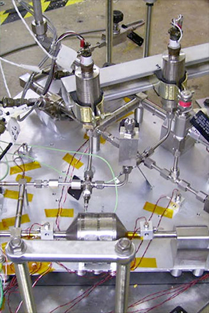

To meet its new function and the much more demanding requirements of the MSL mission, the engineers at VACCO Industries needed to inspect the heritage hardware, modify it and devise a means to test it.
"The regulator [for MSL] had more stringent requirements than the shuttle regs as far as leakage and performance," said Dave Wicke, VACCO's vice president for engineering and technology, "so they had to be rebuilt very carefully so they could meet the greater demands for a long mission to Mars, versus a shorter shuttle mission."
"We had to create an elaborate test facility to model the entire 'seven minutes of terror,'" added Habis, referencing the title that NASA use to describe MSL's dramatic entry, descent and landing (EDL).
VACCO engineers modified the shuttle hardware with new components and serviced it so it was "like new."
"It really went out of here like it was a new unit from us. The only difference was that the raw material came from the shuttle regulators," said Wicke.

A special pressurization control assembly test, pictured here, was conducted to verify the space shuttle heritage regulator would still operate with a pyrovalve shock and slam start. (NASA/JPL-Caltech)
