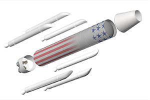

The new booster will also increase the number of possible side-mounted solid rocket motors by one more than Atlas, for a total of six, providing up to 20 percent more power.

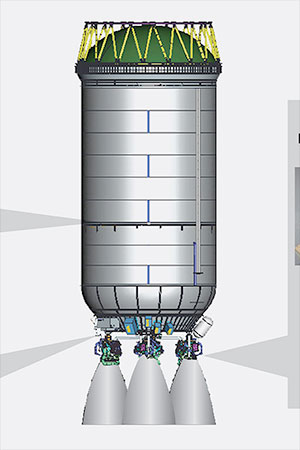

At first, for the flights beginning in 2019, ULA plans to pair the new Vulcan first stage with its existing Centaur upper stage used with the Atlas. In the company's second step, the Centaur will be replaced by a more powerful Advanced Cryogenic Evolved Stage (ACES), offering the Vulcan with the ability to match the performance of the Delta IV Heavy rocket.
Step 2, second stage
"We are going to take a giant leap forward in our upper stage," Bruno said. "Burning liquid oxygen and hydrogen, it'll start with these very large high-capacity balloon tanks [that are] so thin, so lightweight, that on Earth they cannot even support their own mass. They would collapse without propellant or pressure to hold their shape. They are truly designed to fly in space."
The ACES will be powered by one to four rocket engines, which Bruno said will be chosen from the existing Aerojet Rocketdyne RL-10 that is used with the Centaur, the Blue Origin's BE-3, or a new engine based on technology being developed by XCOR Aerospace.
The ACES will also incorporate a new integrated vehicle fluids system.
"This is the ultimate in reuse," Bruno explained. "The thing that limits the performance of the upper stage systems in launch vehicles is time — time in space. Eventually our propellants boil off and we're out of usable propellant. This system changes all of that."
Using an advanced internal combustion engine developed by race car manufacturer Roush, the waste propellants will be recycled to re-pressurize the stage's tanks, to generate electrical power and to provide control and attitude thrust.
"This completely changes everything," stated Bruno. "This provides a tremendous extension to our ability to operate on orbit."
"We're going to go from hours to weeks with this system," he continued. "We can take multiple satellites into orbit, we can put them in different planes and when we are done with that we can fly back to space station for operations."

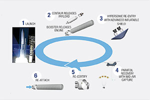

The third step of ULA's development plan is to introduce reusability. Instead of recovering the entire first stage, like its competitor SpaceX has been attempting to do using an ocean-based landing platform, ULA's "Sensible, Modular, Autonomous Return Technology," or SMART, initiative will seek to recover only the first stage engines.
"In this approach, when the booster is done and you are finished with the rocket engines, we will cut them off, we will return them to the Earth using an advanced inflatable hypersonic heat shield and then with a very low, simplified logistics footprint, we'll recover them in mid-air and return them to the factory to quickly recertify them and then plop them under the next booster to fly," Bruno described.
"This will take up to 90 percent of the propulsion cost out of the booster," he stated, adding that SMART is only the beginning of the company's plans for how to reuse other components of its launch system, with more details to be announced later.

ULA's Vulcan first stage is powered by a pair of Blue Origin BE-4 engines and up to six side-mounted solid rocket motors. (ULA)
ULA's Advanced Cryogenic Evolved Stage replaces Centaur as the upper stage on the company's new Vulcan rocket. (ULA)
ULA's Sensible, Modular, Autonomous Return Technology uses a hypersonic inflatable heat shield and parafoil to recover Vulcan first stage rocket engines by mid-air capture. (ULA)
