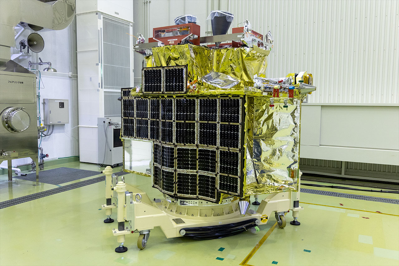

JAXA's Smart Lander for Investigating Moon (SLIM) as seen before it was launched from Japan in September 2023. (JAXA)
