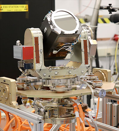

Above: The O2O project recently completed the integration and alignment of the O2O optical module (pictured).

In preparation for Artemis II, the O2O team will build the space terminal and integrate it into the Orion spacecraft. The space terminal consists of three major components:
- The optical module is comprised of a 4-inch telescope and two gimbals that point the telescope toward ground terminals on Earth.
- The modem converts mission data and commands to and from laser beams for communication via the optical module.
- The controller electronics contains a computer interfacing with the Orion flight avionics and custom interfacing electronics for control and the pointing of the optical module's Telescope.
