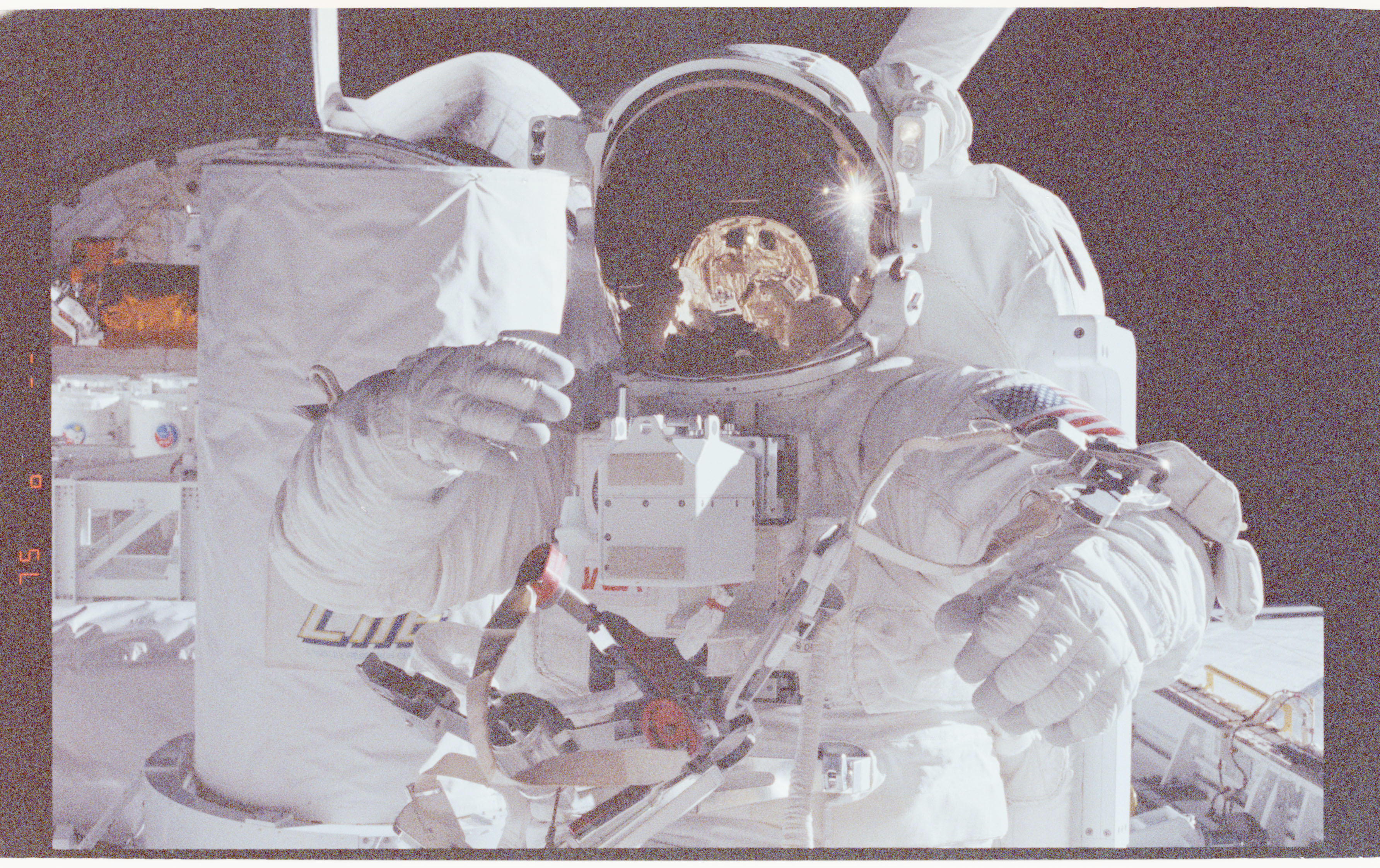

posted 10-07-2023 09:12 AM
How was the SAFER controlled after STS-64?
Compare these two EVA images: the first photo shows Carl Meade on STS-64. The second photo shows Chris Cassidy on Expedition 63.
On STS-64, Lee and Meade used a Hand Controller Module (HCM) to test the SAFER unit. The HCM was attached to the EMU Display and Control Module on the front of their spacesuits.
After STS-64, you typically do not see the HCM on EVA astronauts (like Cassidy) wearing the SAFER. So how did those astronauts control the SAFER had they needed to use it?
Jim Behling Member
Posts: 1931 From: Cape Canaveral, FL Registered: Mar 2010
posted 10-07-2023 03:26 PM
quote:Originally posted by LM-12: So how did those astronauts control the SAFER had they needed to use it?
It is stowed on side of the backpack. The astronaut grabs it and uses both hands on the controller.
LM-12 Member
Posts: 3973 From: Ontario, Canada Registered: Oct 2010
posted 10-09-2023 05:21 PM
Thanks for that response. Photos showing the HCM stowed are not easy to find, but it looks like the HCM is stowed under the SAFER in this STS-76 EVA photo.

Here is a bit of trivia from "Walking to Olympus" about the tethered EVA by Linda Godwin and Rich Clifford on STS-76:
Clifford wore the flight test SAFER unit used on STS-64, while Godwin wore a refurbished ground test unit.
Clifford was wearing SAFER #2 and Godwin was wearing SAFER #1.
