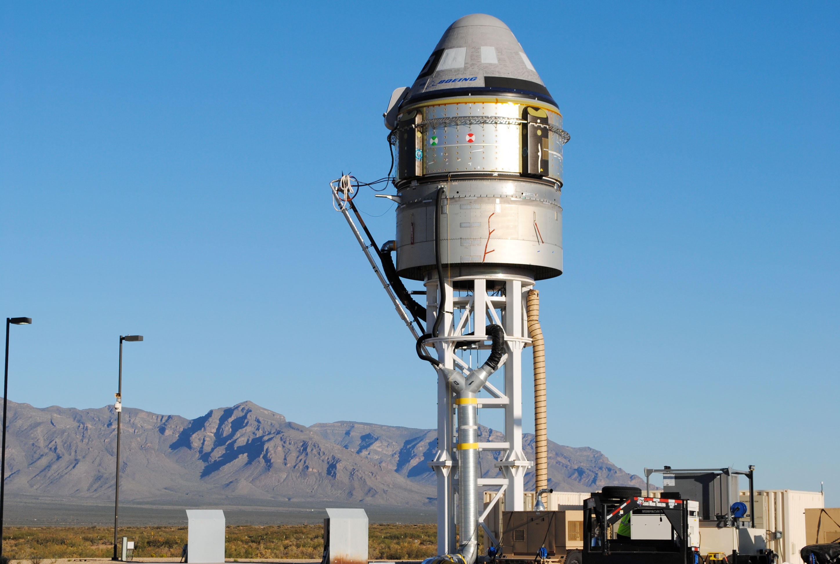

Above: Boeing's CST-100 Starliner spacecraft and its service module sit atop the test stand at White Sands Missile Range in New Mexico ahead of the company's Pad Abort Test. The test is scheduled for Nov. 4, 2019, and will demonstrate the spacecraft's ability to quickly escape the launch pad in the event of an emergency on launch day. (Boeing)
