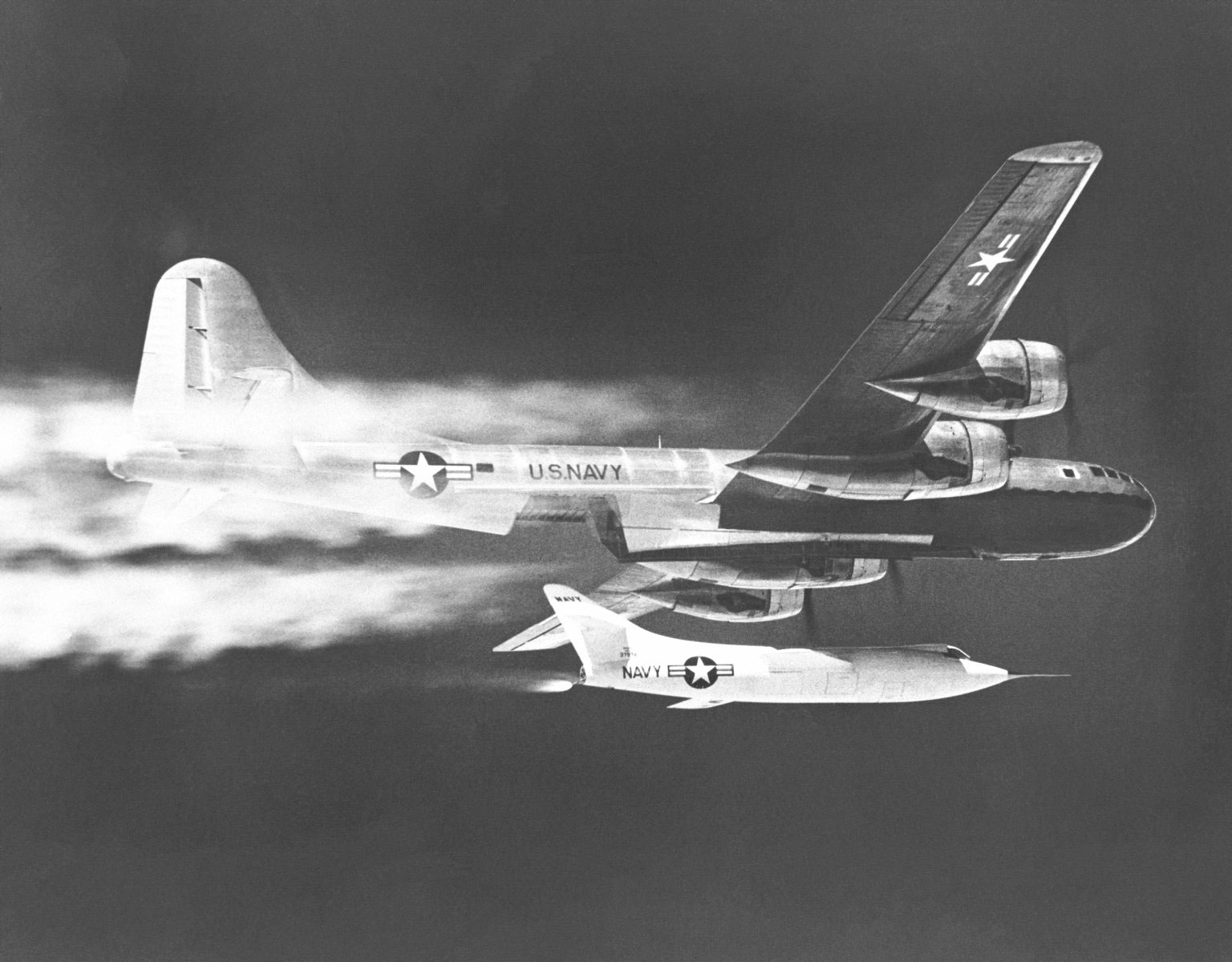

This 1950s photo shows the D-558-2 Skyrocket launching from a P2B-1S mothership at the NACA High-Speed Flight Station (later Dryden) in California. The P2B-1S was the U.S. Navy version of the B-29 bomber.
In March 1956, there was an in-flight emergency. The D-558-2 pilot was Jack McKay. The P2B-1S mothership pilots were Stan Butchart and Neil Armstrong.
The caption says that the D-558-2 was jettisoned "after" the prop failure. Wouldn't that have been disastrous for both aircraft and both crews?
A second source here mentions the D-558-2 was launched seconds before the prop failure, which seems more likely.

Per Butchart's account in "Toward Mach 2: The Douglas D-558 Program" NASA SP-4222, they dropped the Skyrocket seconds before the P2B's engine uncorked. Other accounts indicate that the prop blade went right through the P2B's bomb bay, right where the Skyrocket had been (loaded with rocket fuel) just seconds before.

The post-landing photo of the damaged P2B-1S (B-29) also shows that the propeller blades on engine #3 were feathered to reduce wind resistance.
oly
Posts: 1210
Registered: Apr 2015
posted 04-12-2021 09:55 PM     Click Here to See the Profile for oly   Click Here to Email oly     Edit/Delete Message   Reply w/Quote
More telling is the fact that number two prop does not appear to be feathered. With this engine out, it would have acted as a huge drag, making controlling the aircraft with only one working outboard engine even more difficult.
