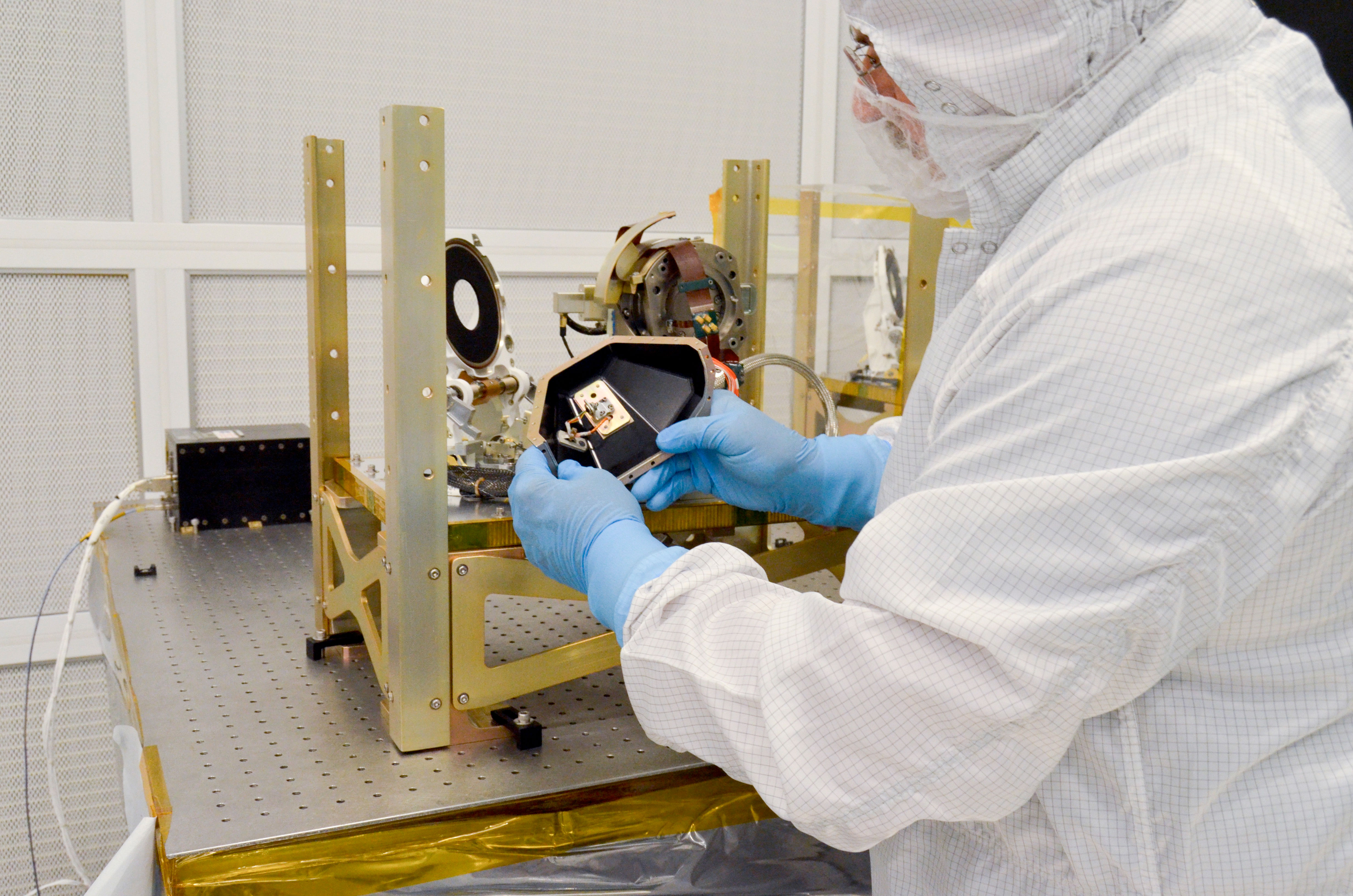

Above: An engineer examines the gimbal and latch assembly component of one of LCRD's two optical module assembly. The optical module, when combined with the modems and controller electronics, make up the LCRD's flight payload. (NASA GSFC/Sandra Vilevac)

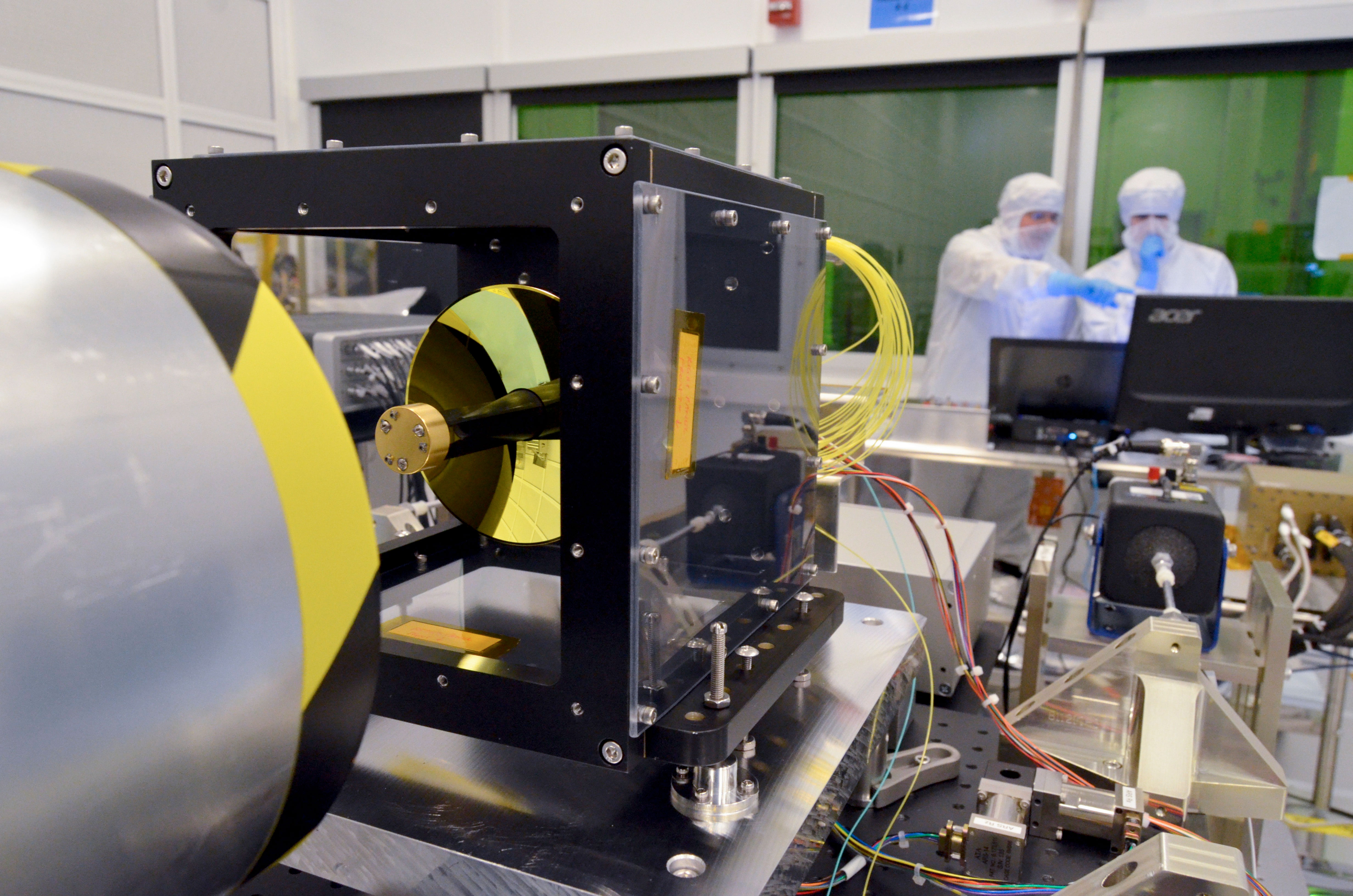

Above: Engineers are currently testing the optical module assemblies on the Goddard-built optical test bench to ensure pointing accuracy during the upcoming mission. (NASA GSFC/Sandra Vilevac)
The modems translate digital data into laser or radio-frequency signals and back again. Once they convert the data to laser light, the optical module will beam the data to Earth. To do so, the module must be perfectly pointed to receive and transmit the data. The controller electronics (CE) module commands actuators to help point and steady the telescope despite any movement or vibration on the spacecraft.
