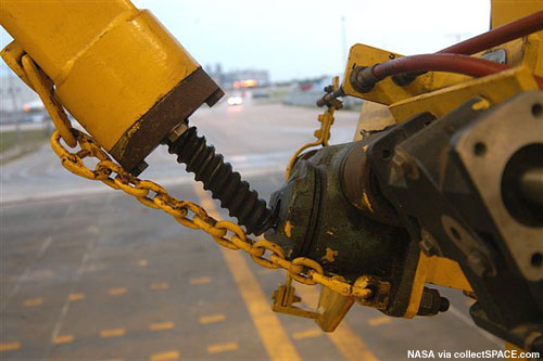

This morning's scheduled rollover of Discovery from the Orbiter Processing Facility (OPF) to the Vehicle Assembly Building (VAB) in preparation for STS-121 has been delayed by a minimum of several hours as engineers troubleshoot a snapped screw on the VAB sling set that is used to mate the orbiter to the ET and SRB stack.Initial reports out of NASA are that the jack screw is not critical to lifting the orbiter. Shuttle technicians are evaluating the other screws on the sling set while trying to locate a replacement (even looking at the Vandenberg Air Force Base [California] sling set for a potential spare). Discovery will remain safe inside the OPF while this issue is worked. Though NASA hopes to still conduct the rollover today, weather becomes a concern as the day progresses, SPACE.com reported. A picture of the jack screw follows: |

Update: Rollover has been rescheduled to 8:00am EDT Friday, May 12. |

It just goes to show you, the Space Shuttle is not the only thing getting old in the program. GSE can be every bit as important as the vehicle it serves. I wonder what would have happened if it was being used and will this delay the stacking as they check out all of the attachments? The photo above shows a significant amount of corrosion on the lower end of the jackscrew housing. It would make me question the integrity of the rest of this apparatus as well as those others that have been in "storage" waiting for the program to resume. |

quote: Originally posted by GACspaceguy: I wonder what would have happened if it was being used and will this delay the stacking as they check out all of the attachments?
Stacking has already been completed. Discovery was hoisted just a few hours after it arrived in the VAB. |
