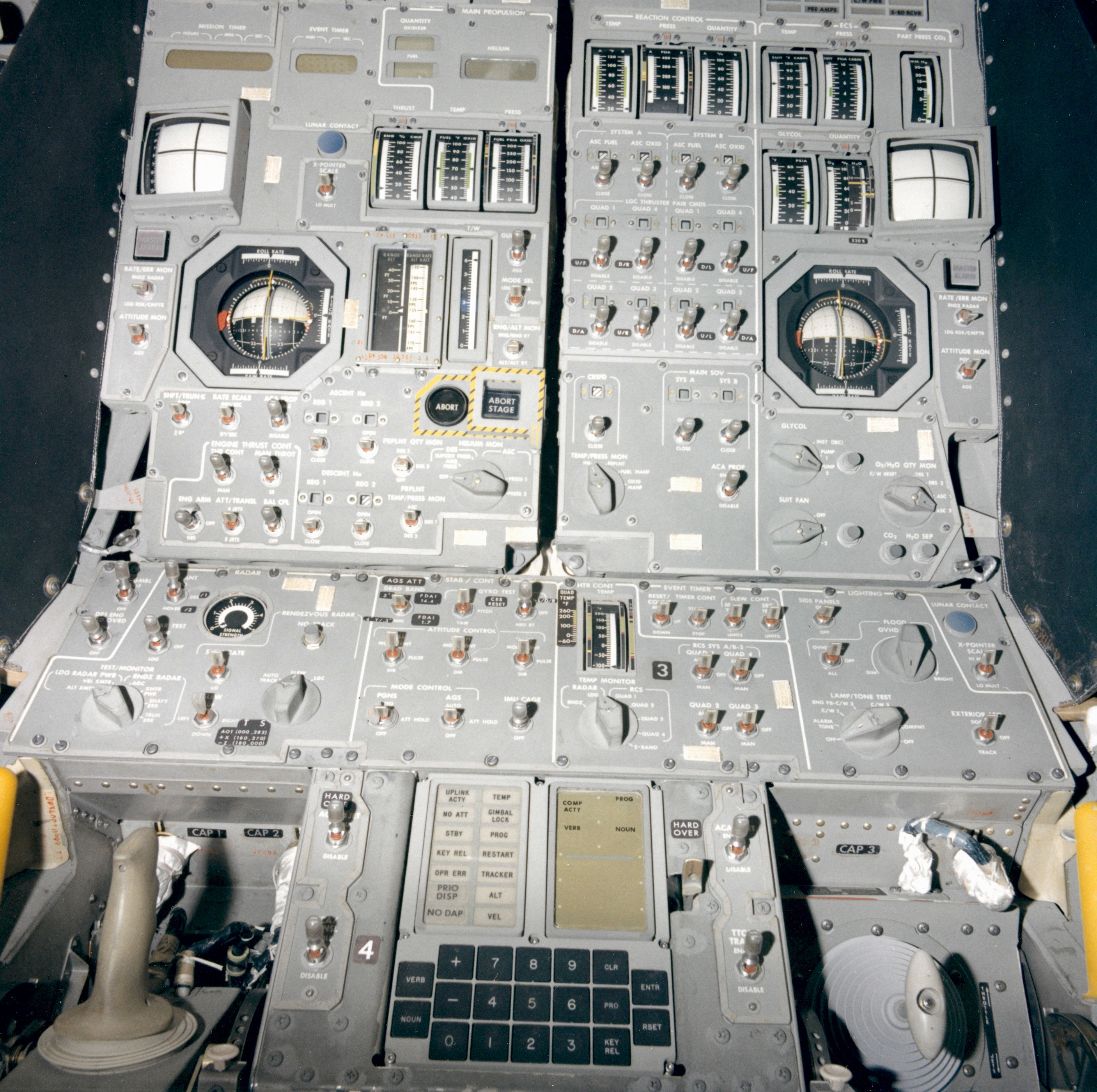

If you are referring to images such as this, where the AGC facia screws have had paint touch up, I suspect that some components have been removed and installed several times during assembly and testing.
In some cases, like the ACG software for the LM, the memory modules were only installed shortly before launch because the coordinate data had to be set, and some other life limited components and consumables were installed before flight.
Note also how most of the screws, rivets, and other fasteners were not painted throughout the LM to save weight, but that the fasteners in front of the crew, withing line of sight, were painted with an anti-glare surface finish to minimize distraction.

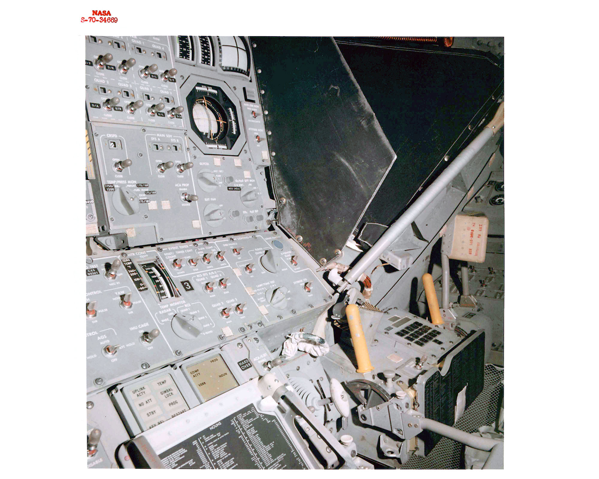

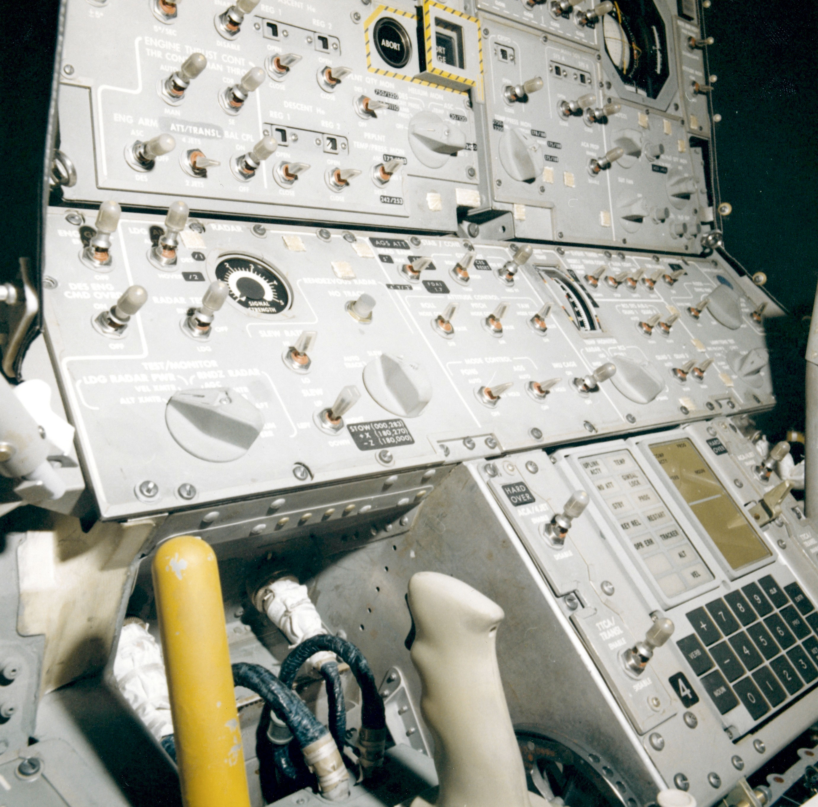

Here are a couple of closeout images of LM-7 (Apollo 13) that also illustrate the condition of the panels, etc.

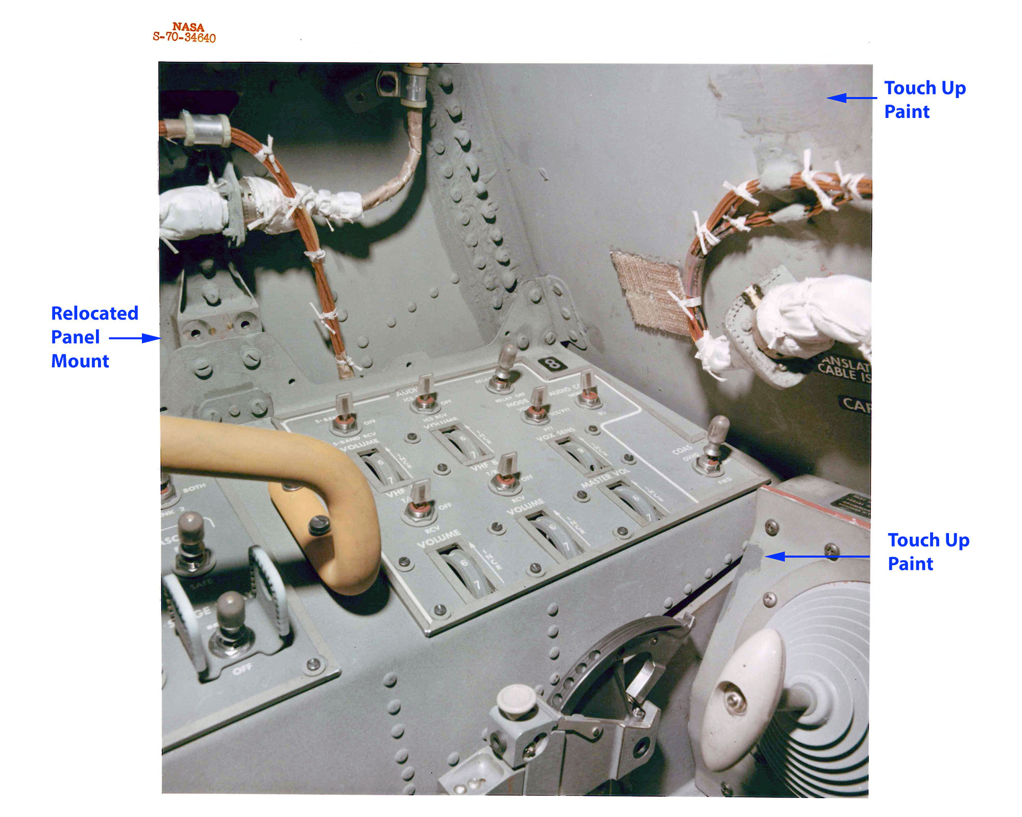

Note in this image of the Apollo 12 LM-6 (Intrepid) cabin close out photo, there is a row of holes below the console that appear to be where some screws or rivets are missing, perhaps whatever went here was made redundant or relocated and a new panel without these holes was never made?
