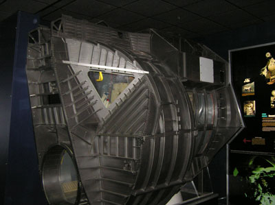

Take a look at this photo of the LM assent stage showing the internal structure (note that this was an earlier configuration as seen with the round front hatch but the basics are the same). ![](http://www.collectspace.com/review/gacspaceguy/lem_pressurization01.jpg) The skin has a number of structural elements that are referred to as stiffeners attached to the outside of the skin. The construction is the same as aircraft structure and the thickness and fasteners are the same as well. Just as a commercial airline is pressurized (typically with a pressure higher than what was used in the LM) yet does not gain or need any structural benefit from it, neither would the LM. Just for an example, if you have ever flown a Canadair Regional Jet 700 (CRJ) the only thing between you and the open sky is an aluminium skin that is 63 thousands of an inch thick at the places where frames are attached and only 40 thousands of an inch in the open bay areas. As long as the vehicle is designed to dissipate the load that is being applied correctly, it is amazing what it can withstand (plus the built in factors of safety, but that is another story). |
Saturn V Member Posts: 176 From: Golden, Colorado, USA Registered: Nov 2006
posted 08-04-2010 12:27 PM
It really does take a rocket scientist to figure this stuff out. ![](http://www.collectspace.com/ubb/smile.gif) Very nice photo by the way. |
