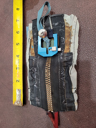

Here is a BF Goodrich zipper that I purchased with a large collection of Gemini, Apollo and Shuttle items from a Goodrich engineer. This is a double zipper for a pressure suit, there's no history on it, but it's a very interesting piece of engineering. I can't get the large zipper to move but the small inner zipper works fine. Any ideas what suit it could be from? ![](http://www.collectspace.com/review/spacepsycho/bfgoodrich_zipper01.jpg) ![](http://www.collectspace.com/review/spacepsycho/bfgoodrich_zipper02.jpg)

DG27 Member Posts: 268 From: USA Registered: Nov 2010
posted 10-29-2020 01:16 AM
Your zipper section is from an A7L suit. It has that nicely machined redundant lock to prevent the pressure zipper from inadvertently pulling open. |
