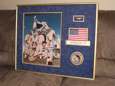

Here is my latest framing job which includes a flown American flag from Apollo 12 from Moonpans, Apollo 12 crew signed picture, from Steve Smith, Apollo 12 patch from Chris Spain and Navy Astronaut wings, from eBay. The flag certificate is just just hidden under the matting and was not cut or damaged in any way.What does everyone think?

328KF Member Posts: 1234 From: Registered: Apr 2008
posted 02-25-2013 05:40 PM
Love it! The blue suede mat looks really nice, and the portraits are a nice touch. A couple of questions:Did you stitch the flag to the back mat material or attach it otherwise? I bought the correct size sleeves from Archival Methods mentioned above, and I plan to frame it inside that sleeve. It is virtually invisible, holds the flag stiff and keeps it from "drooping", and I can use acid free tape behind it without worrying about staining the flag. Also, do you know if the wings are correct for the time period that GT-4 flew? For those who didn't realize it, I believe those flags are the same ones the crew put on their spacesuits as the first unofficial crew patch. Having seen close-up shots of the actual flags on the suits, they appear to be of the same material and the stars and stripes are identical, including the slight overlap of the red stripes into the blue area. Thanks. Again, great job! |
