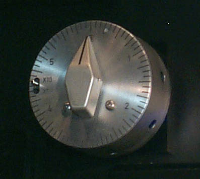

I would appreciate any help in acquiring further information — and a photo or a diagram of — an Apollo Interval Timer.
It is my understanding that it was a mechanical, spring driven device (much like an egg timer) carried in the Apollo command modules for backup purposes and was kept in a stowage locker.

Here is a photo of a two-speed mechanical timer from Apollo. The timer is on display at the Kansas Cosmosphere.

Thank you so much. I've been searching every way I could think of for well over a month now to try and find out what an interval timer was and what it looked like. And just like that, there it was in my email box! Wow! Thanks!
It's a pretty cool looking piece isn't it? It doesn't look like something NASA just picked up off the hardware shelf does it?
